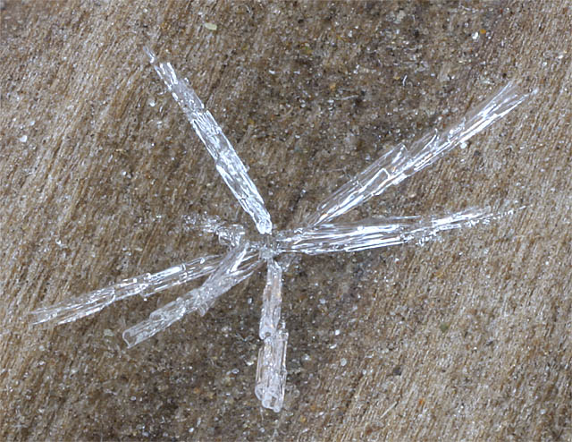

Frost Spikes 3
Bald Eagle, this one's for you.
The frost was small this morning. This cluster was only 5mm wide from tip to tip.
Technical stuff: This picture is cropped from a Helicon Focus stack of 15 images, shot at 11mm field width (2X onto the sensor), using Canon 300D with a 50mm El Nikkor enlarging lens reversed on bellows. ISO 200, f/16 setting (f/48 effective), 1 second shutter.
There's not much working distance with such a short lens, but I haven't shelled out yet for a long macro setup. That's why I'm so interested in your Sigma 150 plus tubes.
Previous posts: Frost Spikes, Frost Spikes 2

Mike, thanks for the suggestions.
Yes, I do shoot Canon, and the MP-E-65 is a very interesting lens. I'm still trying to figure out how it might fit with the spectrum of stuff that I do. A bit of guesswork, since I've never had the chance to play with one.
I'm always amused, looking at the MP-E-65 writeups, at one beautiful piece of specsmanship. The spec sheet says "Closest focusing distance: 0.24m / 0.8 ft. (from film plane to subject)". Um, yeah. Except there's a inch from the film plane to the lens mount, and the lens itself is another 3+ inches long, and...
What's the actual working distance for that beast at 5:1, anyway?

Mike,
Thanks for the additional info about the MP-E-65.
None of this is any surprise, except that I think you're being pretty optimistic about that 1.5mm DOF at 5:1.
Let's assume you image at 5:1 onto a 22mm sensor, and from that, make a final image that's 110mm wide. Then your total magnification is Mtot = 25X, with enlarging magnification Menl = 5X.
As summarized in Ted Clarke's article, diffraction limits you to 330/Mtot^2 = 0.5 mm DOF, even if you're tolerating a pretty fuzzy result (3 lines/mm). Notice that 110mm x 3 lines/mm x 2 pixels/line = 660 pixels. This is strictly web-resolution stuff.
To get this resolution, you'll be running at an f/number of 330/(Mtot+Menl) = f/11.
Stopping down farther doesn't help -- it just makes the whole image even fuzzier. There's a reason that Canon limits you to f/16 on that lens -- they don't want people complaining that the glass is crappy, when the real problem is diffraction.
If you want a sharper image or more magnification, you have to open up even farther. Make that final image be 220mm at 3 lines/mm (1320 pixels) and you've got Mtot=50, Menl=10. You're only going to get 0.13mm DOF, and you'll need around f/5.6 to get it. Make the aperture any smaller and you get useless magnification -- diffraction blur bigger than your pixels.
Next time you have your MP-E-65 set up, run some tests and check it out for yourself. One of my friends who ran exactly that experiment with his MP-E-65 was rather surprised to see that f/16 was not his friend at 5:1.
All of the above explains why I stacked this cluster of frost spikes. I needed about 5mm total DOF for a subject that's only about 6 mm wide. But that's Mtot=18, and the best I can get in an individual frame is only 1 mm DOF at web resolution. Solution: step focus and stack 'em.
Yeah, high-magnification stuff is a pain. Those dang light waves are just too big!

- Posts: 727
- Joined: Fri May 06, 2005 11:57 pm
- Location: Richland, WA, USA
- Contact:
Right, effective f/stop = nominal f/stop * (1+magnification) .MikeBinOKlahoma wrote:If I remember right, it is actually at f/96 or something like that. A nice f/stop for large format, but not for l'il ole 35mm!
And to get the same DOF effects (both geometric and diffraction), the effective f/stop should be proportional to the sensor size. So f/96 on 8x10 acts just like f/12 on 1x1.25 (35mm, cropped).
(The more times and ways I say these things, the better I understand them. If you get something useful from my ramblings, so much the better. )
- Posts: 727
- Contact:
Glad you like it!Bald Eagle wrote:Thanks Rik, WOW, it looks even better close up. Very sharp. I will keep posting shots with the Ext tubes with the 150. great working room.
The setup was a bit bizarre and I got lucky with part of it.
Basically I had the camera screwed onto a minitripod, maybe 4" off the deck, pointed down at 30 degrees or so to see the frost spikes.
It worked out just perfectly that this also placed the end of the bellows on the deck, so I had the optics rigidly supported at both ends.
That made it pretty easy to not move anything else while stepping the focus with the bellows knob. It also completely eliminated vibration so I could use the long shutter speed required by natural lighting at that time of the morning. I didn't want to use flash because I've had trouble stacking flash sequences due to slight brightness differences from frame to frame. And, uh, photofloods didn't seem like a real good idea given the subject material.
I have not mentioned it before, but short focal length lenses can present a particular problem with stacking.
The issue is that as you shift focus, you also shift the center of perspective. That means that each of the stacked images is actually shot from a different position, which means that what obscures what changes a little bit from image to image.
This is not much of a problem with very low or very high magnifications, because the relative shift in position is small. But it can get very noticeable around 1:1 with short lenses on bellows. The magnitude of the effect scales inversely with the focal length, and also it is a lot less with telephoto designs that put the entrance pupil deep inside the lens. With the setup I used, I was kind of holding my breath to see if Helicon Focus would be able to handle the perspective shift. With your 150, I'm guessing the shift would hardly be visible.
